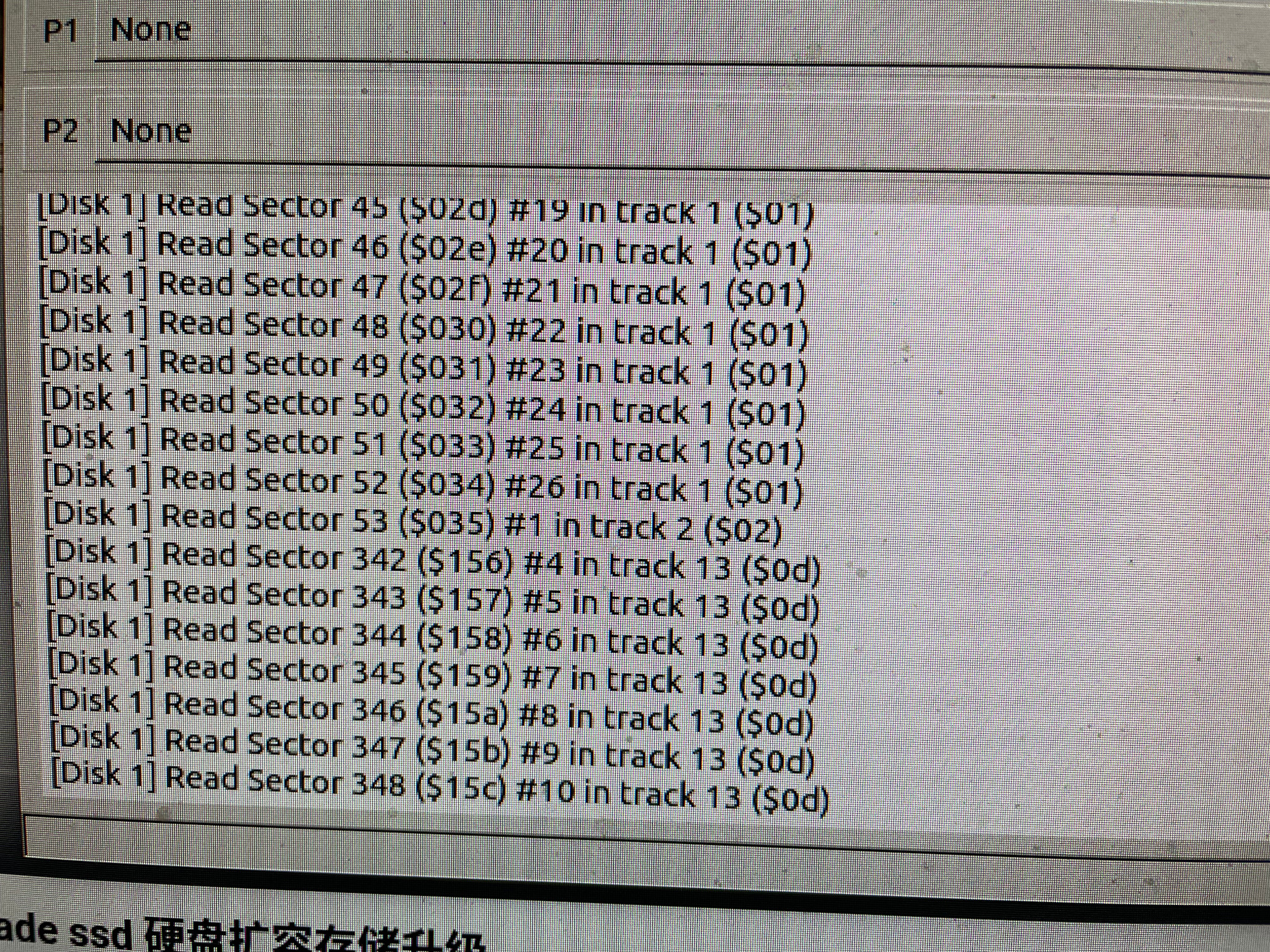

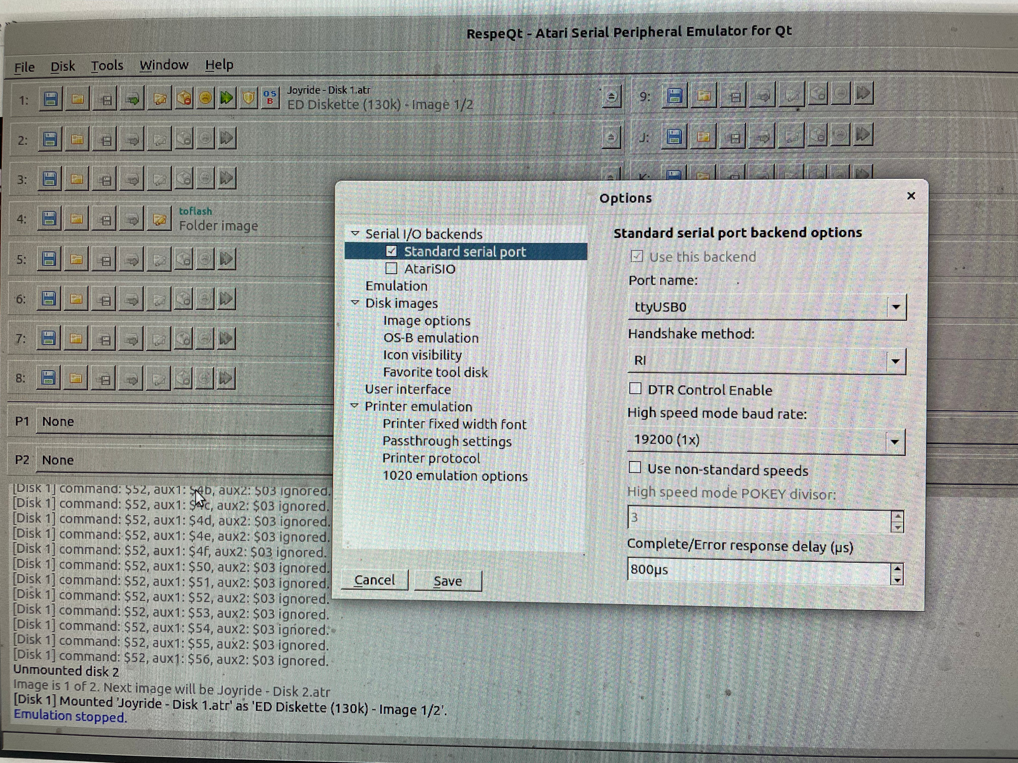

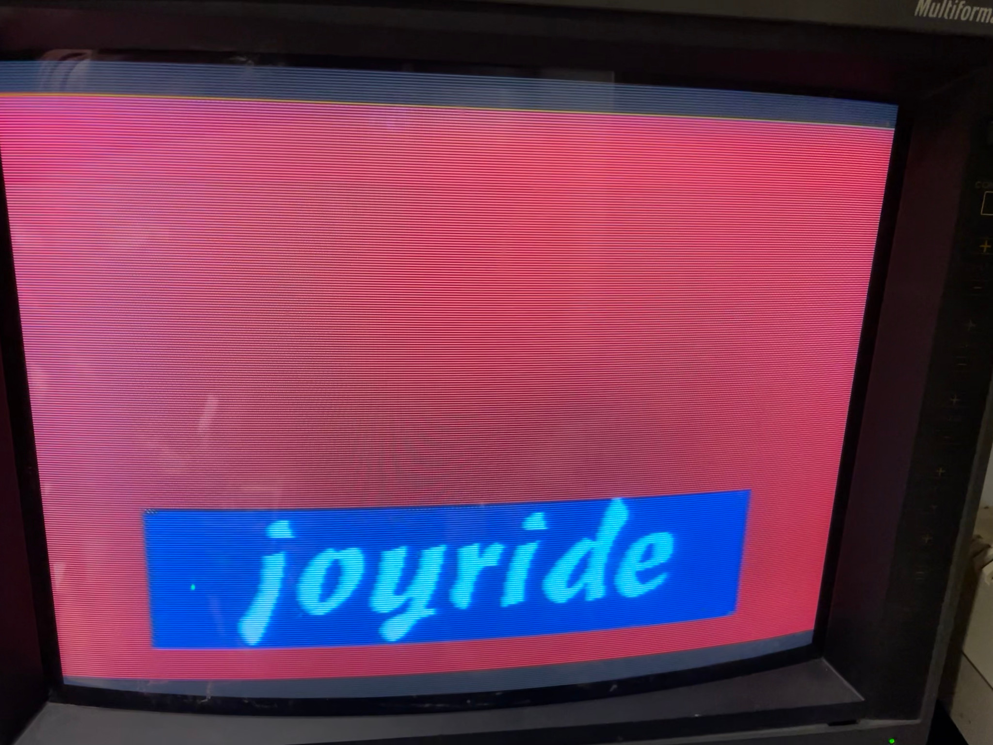

I've attached a screenshot of what I see on Joyride once it starts to load the 2nd part. This is on my 600XL PAL with RespeQT 5.3 and 5.4 rc1 under Ubuntu Jammy (edit: Also I just installed 5.4 rc3 from this thread with the same results). I put in the real GTIA and Pokey to be sure it wasn't my fault!
Here are the settings I used: IMG_2059.jpg
This is what happens as soon as it starts to load part 2: IMG_2074.jpg
This is the display of RespeQT at the time it fails, so you can see the sector that was fetched: IMG_2075.jpg
I copied the image to a real 1050, using RespeQT and copymate XE. Then it worked!
I suspect it may be a timing based Joyride bug rather than a RespeQT issue. Though I guess it wouldn't hurt to double check. I only mentioned it on the other thread because someone thought it was down to a Pokey recreation issue and, in this case, it doesn't seem to be. Since it works with original (using the 1050) or pokeymax (using the 1050) or eclaireXL (using internal drive emulation).
Oh and to confirm the ATR I'm using: $ md5sum Joyride\ -\ Disk\ * 40a6b9cb550723f087d15f927b3671fc Joyride - Disk 1.atr fe4e80e6397fe7756fed02946c4250bf Joyride - Disk 2.atr

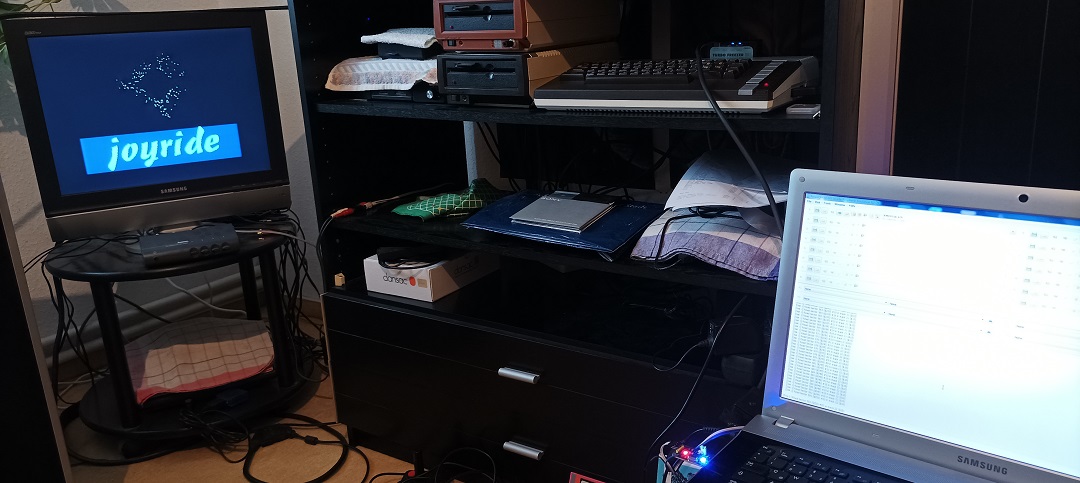

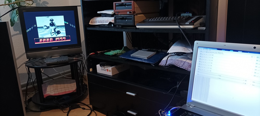

War mal so böse und habe gestern und heute Joyride mit RespeQT getestet - läuft einwandfrei ! Okay, wie immer bei mir, nicht mit der neuesten Version und dem neuesten OS...

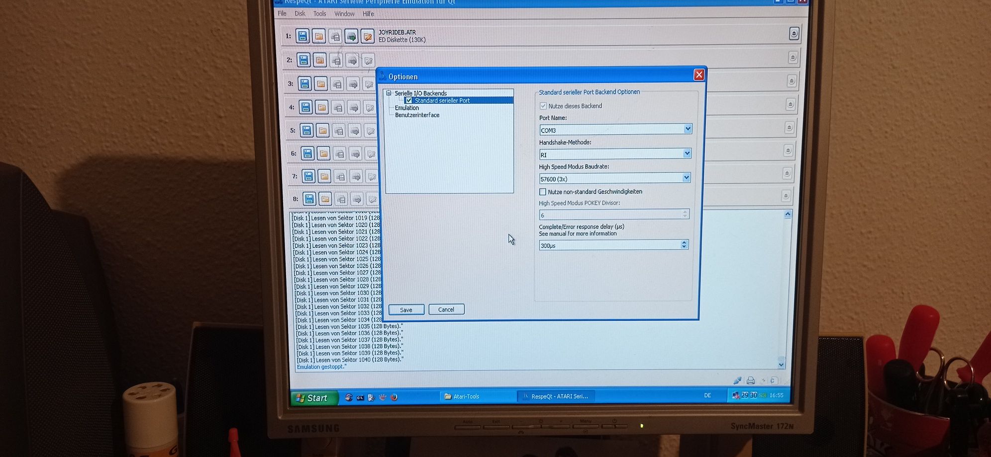

PC (alter Dual-Core, 2x 3.1Ghz): OS: Windows XP 32 Bit SP3 (Zweit-PC, ohne Internet, weil mein Erst-PC ist ein Atari mit 600 Baud Internet) - RespeQT: R4 (Version 4.x, also 4.0 oder 4.1 oder so) - Handshake: RI - Highspeed Modus Baudrate: 57.600 (3x SIO) - nutze non-standard Geschwindigkeiten: nicht aktiviert (highspeed Pokey divisor: irrelevant, da inaktiv) - Error Response Delay: 300 us (wo kriege ich das micro-u her?)
Atari (800XL mit original Board und original Tastatur): OS: XL-OS, Rev. 2 per Schalter eingestellt (sonst OS-B) RAM: 64k base RAM + 512k XRAM (intern; SRAM-Erweit. von mega-hz) Pokey: internes stereo-board mit 2x Pokey, ABER: Schalter auf mono gestellt Covox: vorhanden, nicht abschaltbar (nutzt $D6xx, mono) sonst keine Erweiterungen vorhanden
Die A+B Seite der Joyride Demo lädt via RespeQT einwandfrei. Mein PC ist etwas "umständlich" mit dem A8 verbunden: A8 => SIO2PC (alt, Abbuc-RAF) => DB15 auf DB9 Konverter => Digitus Adapter => USB-Verlängerung => PC Der Digitus Adapter stellt mit dem FTDI-Treiber einen COM-Port 3 zur Verfügung. Die Joyride Demo scheint keinerlei Highspeed-Treiber zu haben und in normaler Geschwindigkeit zu laden.
Fast immer, wenn ein neuer Part der Joyride Demo geladen wird, wird zum "Demopart-Loader" gesprungen, dieser befindet sich in den Sektoren 4 - 53 (zeigt RespeQT schön an) und sodann wird der neue Demopart geladen, während zeitgleich eine Zwischensequenz mit Animation und Sound wiedergegeben wird. Kann also durchaus sein, dass ein Problem an dieser Stelle nicht allein an RespeQT liegt (und der Pokey-Einstellung dort), sondern auch am Pokey im Atari (mono/stereo-Pokey, Pokey-Max, Hokey, etc.)...
Jetzt muss ich den Test wohl nochmal mit RespeQT 5.4 wiederholen... ?!?

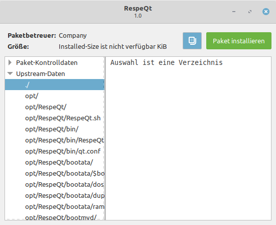

Die DEB-Datei meldet sich mit,
was für mich nicht nach einer portablen Version aussah.
Die Deb-Datei meinte ich nicht mit Installer. Es gibt noch die Datei InstallerRespeQt_5.4.0.run. Diese meinte ich.

Aus irgend einem Grund werden auf deinem System .deb-Dateien als (gzip-)Archiv geöffnet. Früher, als GNOME noch wirklich benutzerfreundlich war, wurden .deb-Dateien mit gdebi geöffnet, von dem aus man das .deb-Archiv gleich installieren konnte.

atarixle schrieb: Aus irgend einem Grund werden auf deinem System .deb-Dateien als (gzip-)Archiv geöffnet. Früher, als GNOME noch wirklich benutzerfreundlich war, wurden .deb-Dateien mit gdebi geöffnet, von dem aus man das .deb-Archiv gleich installieren konnte.
Ähm, das denke ich nicht ...
Die DEB-Datei wird mit gdebi-gtk (https://manpages.debian.org/buster/gdebi/gdebi-gtk.1.en.html) gestartet.
Oh. Klar. Da ist ja der "Installieren"-Button. Hab mich wohl strengstens verguckt. Ich war wohl irritiert von der Dateiliste.

JoSch schrieb: Komisch, ich hatte mit der Version auf Windows in den letzten keine Probleme. Welches Betriebssystem benutzt Du?
Debian 12. Unter Windows hat es immer funktioniert, das ist aber nicht das Thema. Es geht um Linux.
Major Blink schrieb: Hast Du auch den FTDI-Treiber installiert?
Ich habe nichts zusätzlich installiert. Für Linux sollte ähnliches gelten wie für Apple, die FTDI-Module sind schon integriert. Und der Atariserver läuft ja auch über genau dieses Interface.
Ich habe ja auch nur von mir gesprochen, da ich keine Ahnung hatte, was Du benutzt. Allerdings kann ich jetzt nur mal mit meinem Ubuntu-basierten System testen. Ich sage Dir dann Bescheid.
JoSch schrieb: Ich habe ja auch nur von mir gesprochen, da ich keine Ahnung hatte, was Du benutzt. Allerdings kann ich jetzt nur mal mit meinem Ubuntu-basierten System testen. Ich sage Dir dann Bescheid.
Danke! 🙂 Ich warte gespannt. Vielleicht mache ich ja grundsätzlich irgend etwas verkehrt. Deine Einstellungen und die Hardware wären interessant.
Unter Ubuntu 2310 läuft es problemlos. Hat das nicht schon Debian 12 als Unterbau?
Debian 12 hatte ich probiert und wieder gelöscht, ist halt immer noch sehr spröde in der Benutzung.
Du kannst vielleicht noch einen Test machen:
ls /dev/tty*
ausführen mit und ohne Adapter. Wenn es ein Device dazukommt, dann bitte dieses eintragen in RespeQt. Wenn nicht, gibt es keinen passenden Treiber für den Adapter in Deinem System.

Hast Du mal den AtariSIO-Modus probiert? Der geht nämlich meines Wissens durch das Kernelmodul, das atariserver auch nutzt. Evtl. blockiert das Kernelmodul auch den Port und deswegen ist der Port nicht frei für die normale serielle Schnittstelle.
Ich würd mal drauf tippen, dass die Probleme mit dem Atarimax Adapter mit den Modem Control Lines zusammenhängen.
In Atariserver setze ich sowohl DTR als auch RTS auf logisch low: https://github.com/HiassofT/AtariSIO/blob/master/tools/UserspaceSIOWrapper.cpp#L291-L294
    // clear DTR and RTS to make autoswitching Atarimax interface work
    flags &= ~(TIOCM_DTR | TIOCM_RTS);
    if (ioctl(fDeviceFileNo, TIOCMSET, &flags)) {
RespeQt hingegen scheint beide Leitungen auf logisch high zu setzen: https://github.com/josch1710/RespeQt/blob/develop/src/serialport-unix.cpp#L97-L98
    status |= (TIOCM_DTR | TIOCM_RTS);
    if (ioctl(mHandle, TIOCMSET, &status) < 0) {
Den meisten SIO2PC Adaptern ist der Zustand der Leitungen egal, aber IIRC verwenden die Atarmax Adapter DTR zum Umschalten zwischen SIO2PC und 1050-2-PC Modus (oder evtl auch nur zum Ein/Ausschalten des Adapters).

HiassofT schrieb: Ich würd mal drauf tippen, dass die Probleme mit dem Atarimax Adapter mit den Modem Control Lines zusammenhängen. [..]
Die Änderung wurde mal von TheMontezuma eingebaut (https://github.com/josch1710/RespeQt/commit/b4c7be9fb10cbf833c73750b7f931a4912fcf137#diff-acefb1520cffcc410e80b5483e2f0386863de602a09df4fcd0ceee9b3b8f3ad9). Vorher wurden RTS, DTRund RI explizit gelöscht. Commit-Kommentar war: "- set DTR and RTS output lines on opening of the serial port (to support "Arduino Pro Micro" as SIO2PC)". Ich hatte mir scchon gedacht, dass das wieder so ein Fix für ein Spezialproblem ist. Ganz ehrlich muss ich aber sagen, dass ich nur eine oberflächliche Ahnung von serieller Programmierung habe, und daher etwas überfragt im Moment, wie man das Problem für alle lösen kann. Ich kann schlecht, alle verschiedenen Varianten von SIO2PC/USB/XYZ kaufen und jedesmal für alle Betriebssysteme durchtesten. Wenn irgendjemand (@Hiassoft vielleicht Du) mit tieferen Wissen über serielle Programmierung mir mal auf die Sprünge helfen will, dann gerne drüben im Discord, oder sonstwo...
Mal ganz blauäugig und naiv gefragt: Kann es sein, dass Currocks Linux-User nicht die notwendigen Rechte für den Zugriff auf /dev/tty/USBxy hat?
Hmm. Keine Ahnung, ob atariserver sich einfach auf das Kernelmodul stützt und welche Rechte es dafür braucht. Aber schaden würde es sicher nicht, mal zu schauen, ob Currock in der Gruppe dialout ist.
JoSch schrieb: Die Änderung wurde mal von TheMontezuma eingebaut (https://github.com/josch1710/RespeQt/commit/b4c7be9fb10cbf833c73750b7f931a4912fcf137#diff-acefb1520cffcc410e80b5483e2f0386863de602a09df4fcd0ceee9b3b8f3ad9). Vorher wurden RTS, DTRund RI explizit gelöscht. Commit-Kommentar war: "- set DTR and RTS output lines on opening of the serial port (to support "Arduino Pro Micro" as SIO2PC)". Ich hatte mir scchon gedacht, dass das wieder so ein Fix für ein Spezialproblem ist.
Also ich hör das erste Mal von einem "Arduino Pro Micro als SIO2PC".
Die Commit Message klingt für mich aber stark nach "wir haben da was zusammengebastelt dass nicht ganz OK ist und anstatt es zu fixen machen wir einfach RespeQt für Atarimax kaputt, das ist einfacher".
Probiert einfach mal die Änderung zurückzunehmen - der original Code hatte seinen Sinn und wenn das klappt übernehmt sie in den master / development Branch (auch für Win32, da scheint das ebenfalls geändert worden zu sein).

JOYRIDE
ich kann mich erinnern, daß ich auf der letzten Fujiama in einem Rechner das HighSpeed-OS hatte und daß sich M.U.L.E. (Multijoy Version) und Joyride (nur rotes Bild) mit Highspeed nicht laden ließen.
Mit dem originalen Atari Betriebssystem tauchte der Fehler nicht auf.
Verwendeter Laufwerksemulator war APE.
Ja und? Da gibt es reichlich Programme, die die Ressourcen verwenden, die auch in den verschiedenen Highspeed-OS verwendet werden. Eine ganz normale Ressourcenüberschneidung.
Selbst ein abgeschaltetes IDE+ stört da gelegentlich.
Bei Highspeed kommt noch ein lustiger Effekt zum Tragen: Manche Programme laden weiter, während z. B. eine Animation läuft. Da geht dann oft die Synchronisation der SIO flöten. Ein Beispiel dafür ist Yoomp.
Ja, das konnte ich sogar mit einer 1050 bei Joyride nachstellen, als das Thema schonmal auftauchte.
